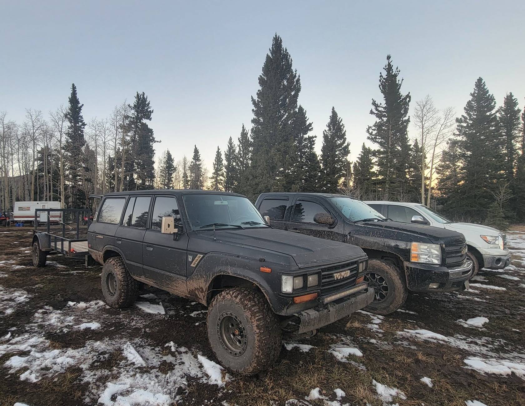

Exactly 💯 I still run a 88 LC with over 460k miles. I Drive it to Sothern Colorado for hunting. It's about 4 just to Alamosa before we make the track up to the Hills.
