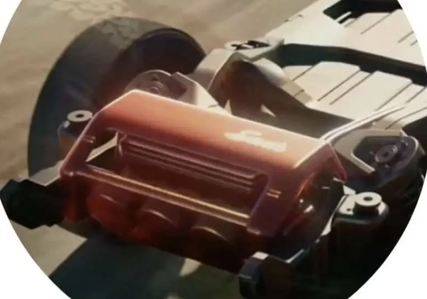

If the Harvester's trailer tow capacity is really only 5,000 lbs., the weight of the engine sitting behind the rear axle might have something to do with it. The BEV version has the entire weight of the (larger, heavier) battery pack forward of the rear axle.
Referring to this (admittedly an early 'artist's conception' of the Harvester unit):
...makes me think even more that the 5,000 lb. tow limit is likely a result of having that much weight that far behind the rear axle. If we assume that the Harvester genset weighs, say, 300 lbs., that's almost like having 300 lbs. on the trailer hitch even before there's any trailer hooked up. The wheelbase isn't that long either, meaning the steering axle has less leverage on the trailer hitch (which may be the main reason the Terra has a lower tow rating than Traveler.)
If they'd sacrificed the 'frunk' the Harvester would have added weight to the steering axle instead, and resulted in a more well-balanced configuration (for towing).
$5 says you’re right. Makes perfect sense…and once again, I really hope they armor the shit out of the underside of that area.
if you’re right, then I could see Scout upping the capacity back to 10K with a WDH. Rivian makes the same claims with their towing capacity - the full rating is only with a WDH and is halved otherwise.

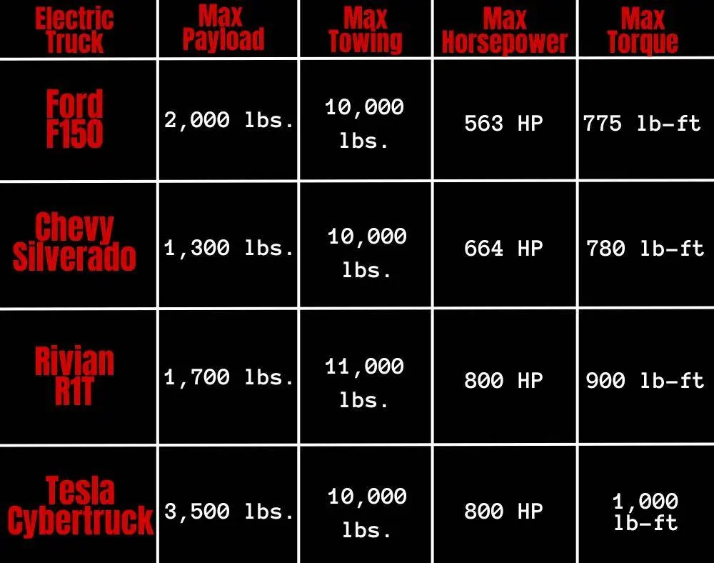

Weight of batteries is (more or less) should be offset by the elimination of the weight of engine, transmission and fuel. Of course towing will reduce battery range, just like towing reduces gas mileage. My hunch is that towing capacity is greatly reduced because you're trying to use an anemic gas engine w/minimalist transmission as a secondary drive train rather than a a pure EV that happens to carry an on-board generator/charger.
I'll add the caveat that I'm not an automotive engineer (aero) and have done minimal research here, but to me it seems like they're over-thinking and over-spec'ing the Harvester and creating a milquetoast option that no one will really be thrilled with.
The fact that the "pure EV Terra" specs line up with this table would support my hypothesis. I'd 100% take a 200 lbs playload hit to just have a 5-gallon tank and a generator built into the truck.
