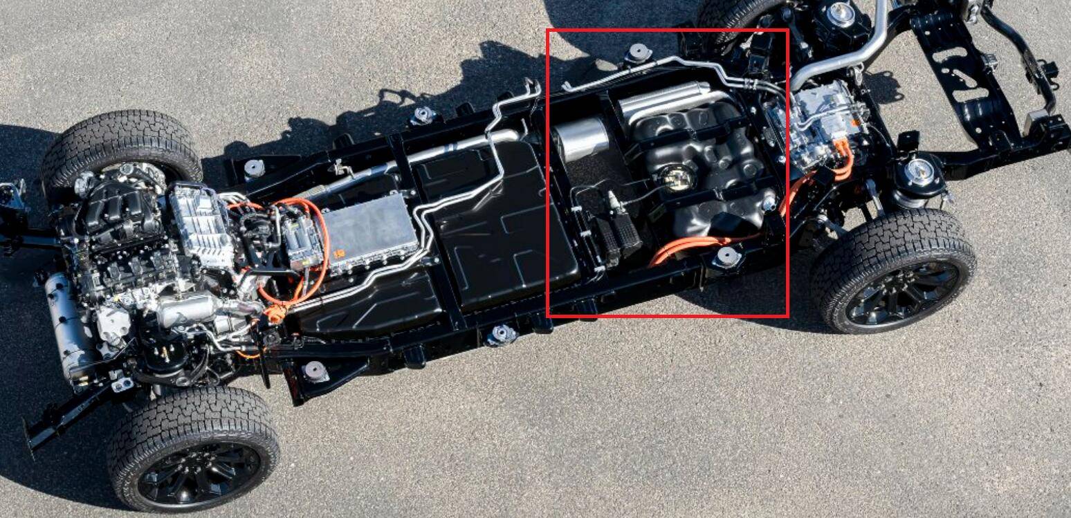

Ramcharger's 3.6 V6 is making 280+ hp and paired to a 130kw generator (170hp). There are losses so it wouldn't ever be a 1:1 and you also don't want your engine maxing out RPMS to generate peak power if you're at all concerned about NVH.
I don't think there's ANY way in hell they are packaging a 3 cylinder and pairing it to a 100kw generator.
The Ramcharger cut the battery in half because to get 500 miles of extended range with that 130kw generator, it needs a fairly good sized gas tank.
With the Harvester's smaller engine, smaller generator, and lesser range (by almost 200 miles) I can't hardly believe they'd cut down the battery in half to make room for a tank like they did with the Ramcharger.
Been hearing that someone at scout suggested 150 miles of EV range...that would be cutting the battery down by nearly 60% if true.
I'm very skeptical of that claim...would like to hear what was said in full context...maybe something being lost in translation.

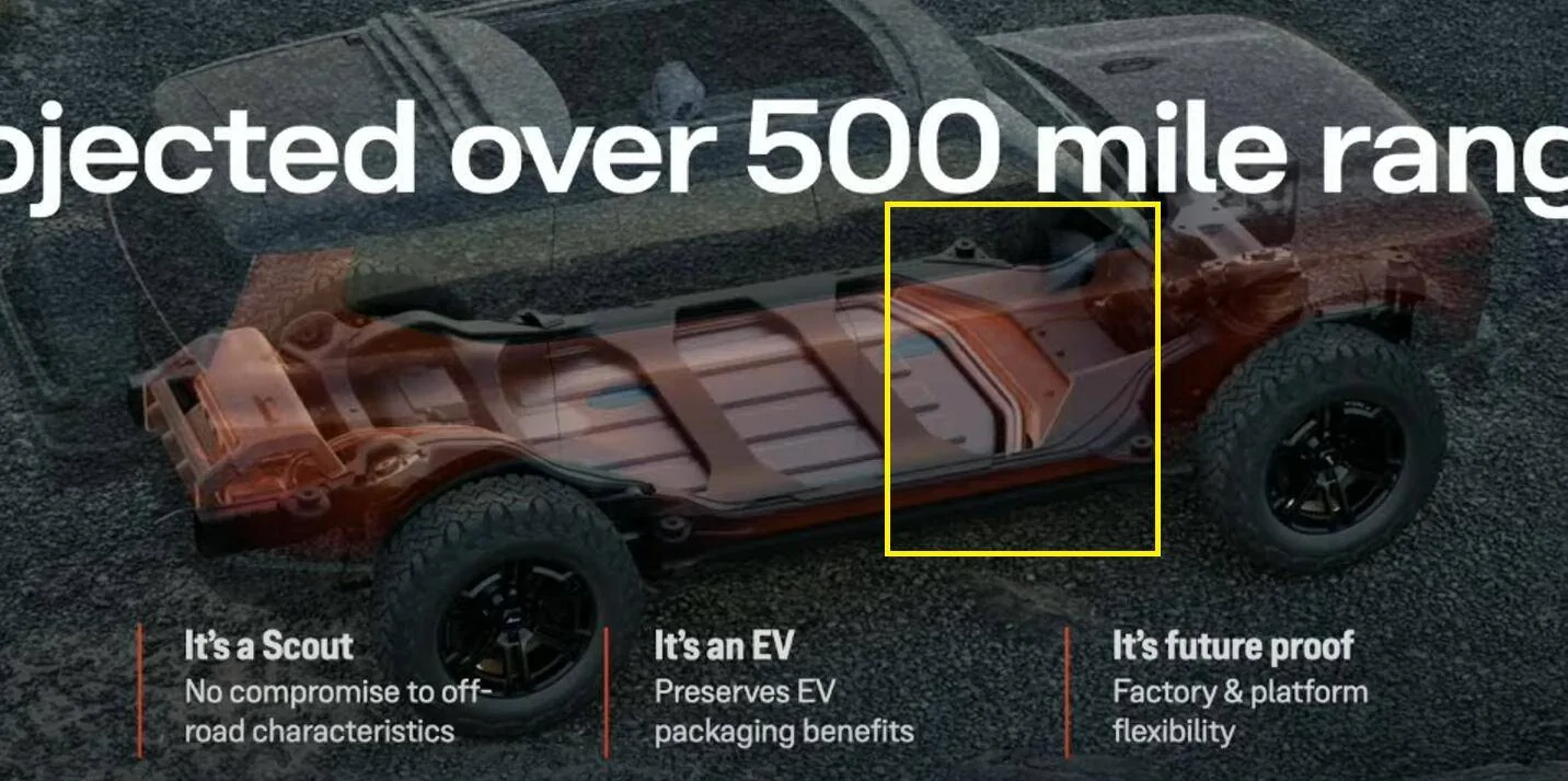

edit: Went back and looked at this image in the reveal...I think they shared with us the location of the fuel tank. If these images can be taken at more than face value...that looks to me to be like a 25% reduction in battery pack size.
44
From a safety standpoint, is it concerning that the gas tank will be in the front with no engine to protect it in a head on collision?
150 miles of EV range comes from Scout. Jamie@Scoutmotors has posted it on their forums. That doesn't mean it's written in stone. Those are just their projections right now. There's an awful lot of engineering that has to occur.
Remember it’s body on frame. So with 2 galvanized steel frames protruding well past the gas tank (it looks like the fuel cell is under the driver/passenger) along with a stout front bumper, it’s well protected.
There are some European vehicles with far less protection…..most Porsche 911’s have no full frame and front mounted tanks without issues, and they are a well sorted vehicle.
