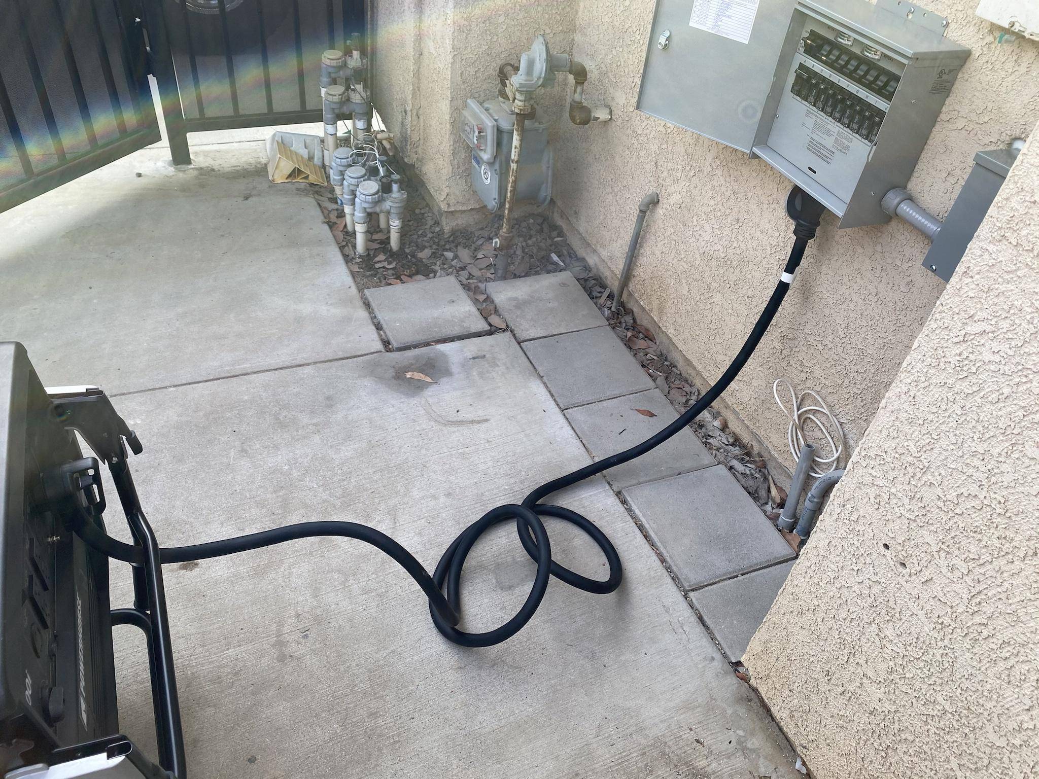

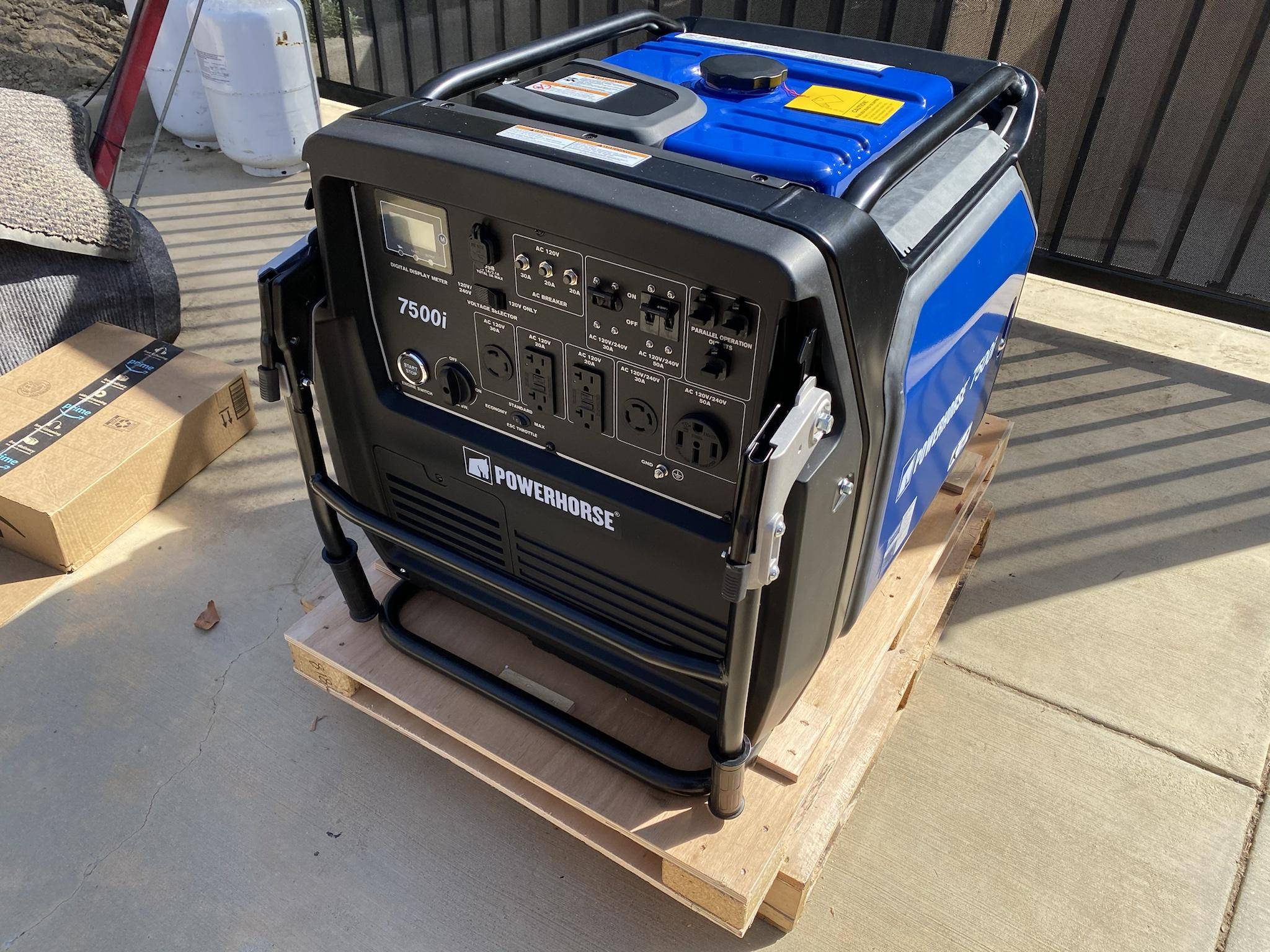

Harbor Freight is releasing a 11.5 KW quiet, clean sine wave, tri fuel generator any day now for a very good price.
Perfect stand-by here, where the power goes out during earthquakes and Santa Ana winds. That means public chargers are down too.
It'll easily supply a 32 AMP / 240 volt charge to your EV. EV6 inhales about 32 miles range per hour on the generator w/one to two quarts of fuel per hour. Slow charging, but arguably impressive economy.
Our 7500i Inverter has been great, now to be accompanied by the new 11.5 KW inverter from HF because I'm a generator fanatic.

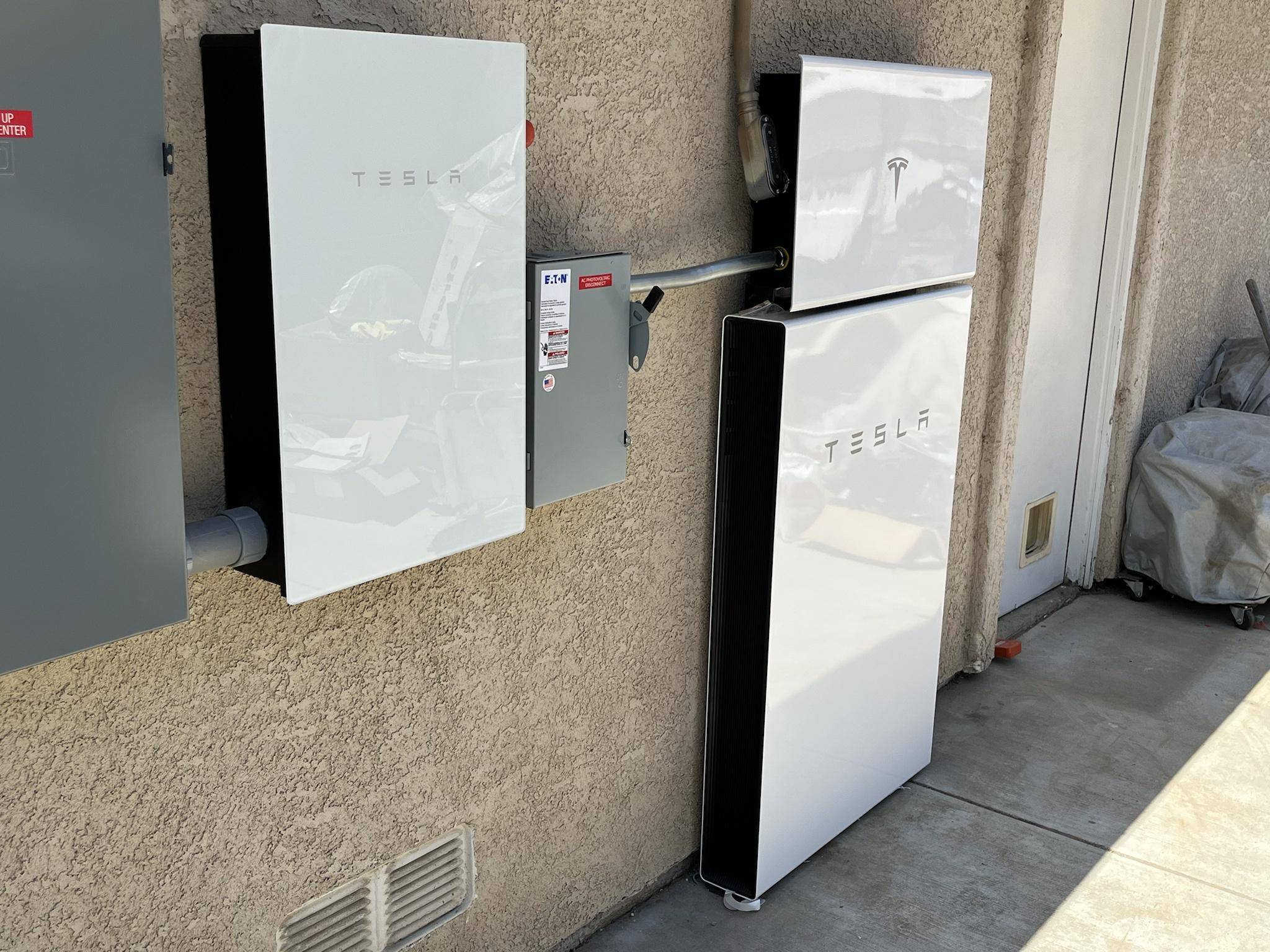

All replaced with this:
