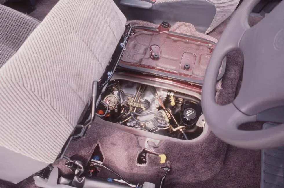

On my Diahatsu Hijet there is an access panel in the bed to the engine and also the front seats lift to access other parts of the engine bay. As already stated Toyota and the vans with the motor behind the front wheels had access from inside. Full size vans you have to pull the "doghouse" to access parts of the engine.
There are several methods of packaging/access that companies have. I am sure they will have a creative solution.
